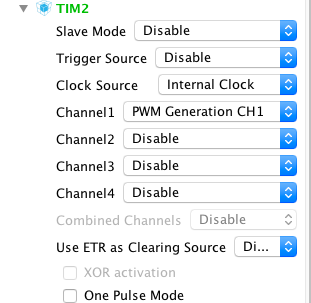

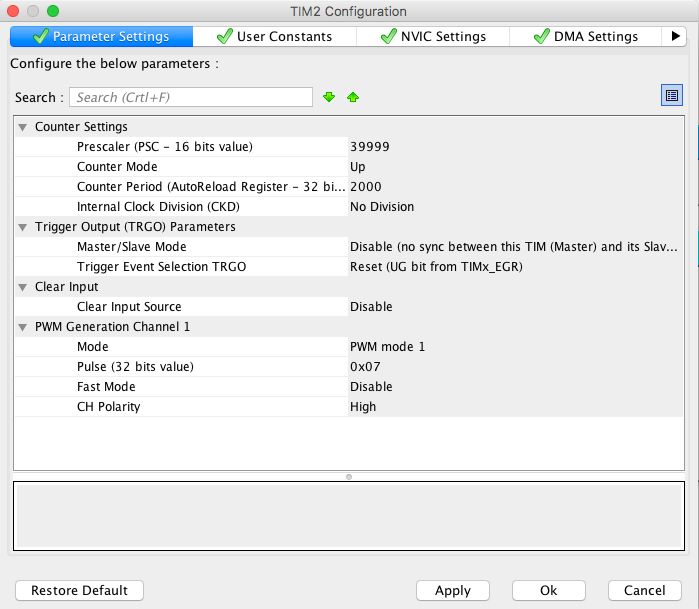

Answered my own question. PWM with a short duty cycle.
prescaler 40000-1
period 2000
gives me a pulse every second or so on an 80MHz L476
and on an STM32L476-Nucleo board, TIM2_CH1 outputs to pin PA0.
