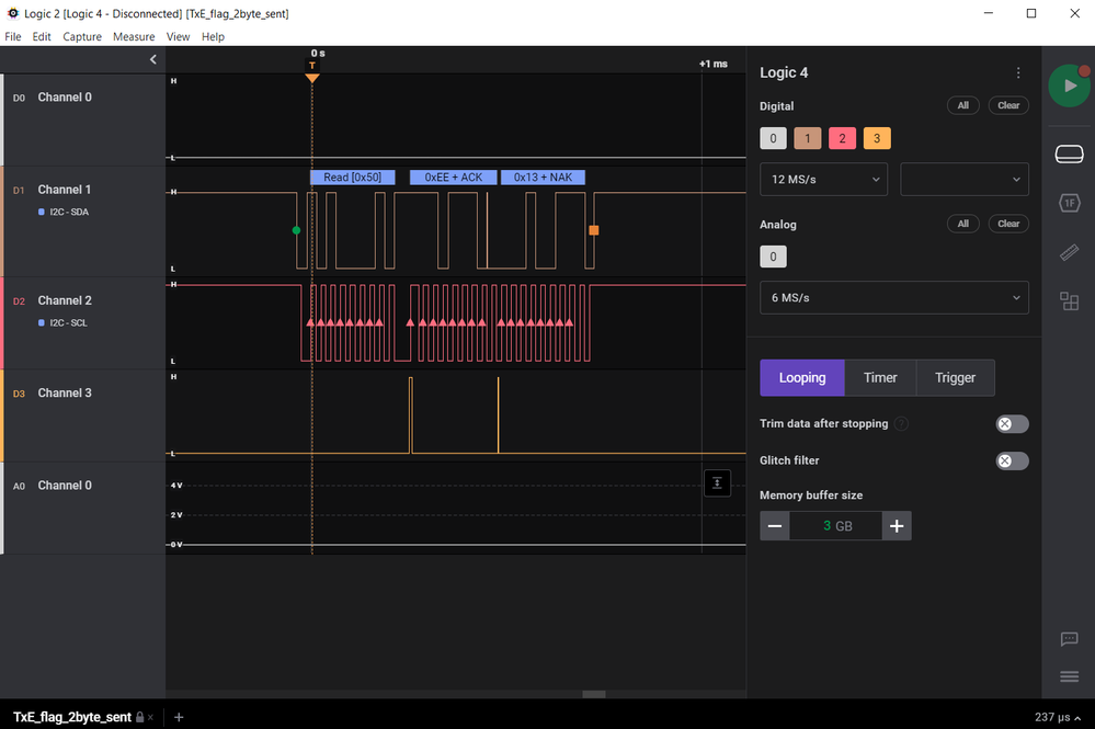

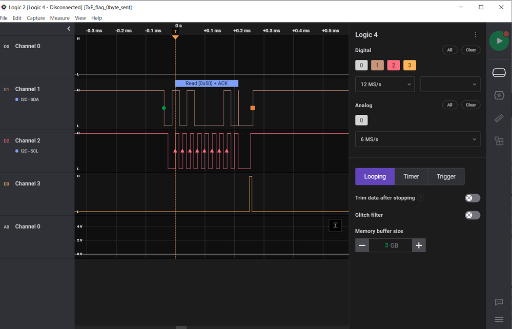

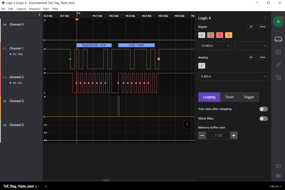

2022-05-23 4:21 AM
I have made a hack to set a debug pin when TxE bit is set during an interrupt, and clear the debug pin when TxE bit is cleared after DR is written.
I can see that TxE toggles 2 times when host reads 2 bytes, but it only toggles 1 time when host reads 1 byte or 0 byte.
Attaching screenshots from logic analyzer capture. (Channel 3 is the debug pin reflecting TxE bit)So I really don´t understand why I receive 2 I2C_SlaveTransmit_TXE callbacks when reading 0 or 1 byte now.
2022-05-24 4:14 AM
I think figured it out.
From Reference Manual:
"Note: TxE is not cleared by writing the first data being transmitted, or by writing data when BTF is set, as in both cases the data register is still empty."
So, what happens is that Slave goes into to transmission mode, TxE is set high, I2C_SlaveTransmit_TXE is called once and writing to DR, immediately after (approx 5.5 us later), a second event IRQ occurs since TxE is not cleared by the first write to DR and I2C_SlaveTransmit_TXE is called again, but this time TxE is cleared.
So it is by hardware design that the driver has to send 2 bytes after a start condition. Probably makes sense if the first write goes to the DR, and second write pushes it to the Data shift register, which means 2 writes are necessary to put the first byte into the SDA line.
