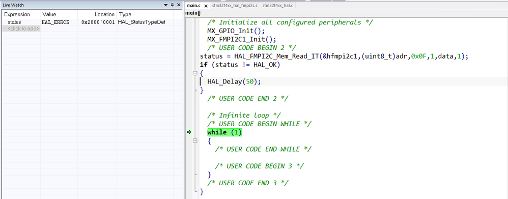

I am aware of the definitions. I have checked the function HAL_I2C_Mem_Read_IT() by setting a pin high before entering, and low after exiting the function.
A, I2C read operation is of 2 parts. The first is a Write, comprising the device address and the subaddress, after that is a repeated read and the device should respond with data.
Until the Ack is received in the first write part of the transaction, the task is blocked.
HAL_I2C_Mem_Read_IT() claims to be non-blocking, but that isn't entirely true; where the write aspect is blocking. It conveniently returns an HAL_Error if a NAK is returned after the write aspect.
Without a status callback indicating an error such as a NAK after the first Write I guess someone has considered this a compromise.
