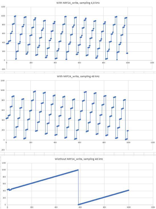

I try to sample sound at 48kHz using ADC. I use the DMA circular mode. I am using HAL libraries and discovered that HAL_ADC_ConvHalfCpltCallback is called twice sometimes. I get 32 samples from adc, when I get half of them I send them and then when i get HAL_ADC_ConvCpltCallback I send another 16 samples. I did a test with counter, I debugged and saw that sometimes halfCplt callback is called twice. I should get a straight line but that is what I get.

EDIT: I send this info using RF, is it possible that this function takes to much time? If I rewrite my code using only HAL_ADC_ConvCpltCallback, when debugging I see that ADC works well but when test[n]=dataToSend1[i] i get 0 values.

}I did some maths. My NRF24L01 is set to transmit data at 2Mbps, this is theoritically max. I sample audio at 48 kHz, for now I just sample one channel so the bitrate is 768 000 bps. I reduced the sampling rate to 4,8 kHz and it did not help. I noticed that when I comment out NRF24_write, it works well.
I send the data without the acknowledgment, maxium data send at one time is 32 bytes that is why I send packages of 16x 2 Bytes samples. Does it mean that fuction responsible for sending data takes to much time? I checked when debugging ,internal sec register and measured the time of executing NRF24_write function.
The time is 0,01s, I do not know if it is correct in keil uVision. That would mean the bitrate is only 25 kbps. I checked also the flags but as I said it looks like while(1) loop is omitted sometimes when debugging, but you said that debugging may not be useful..

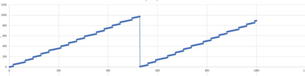

I got it working with 48 khz sampling using TIM2 and nrf24_write function but I am concerned. It only works when I set adc sampling time to 480 cycles. I got 12 bit resolution. The PCLK2 is 48 Mhz and the prescaler is 8 so the ADCCKL is 6 Mhz. So the sampling time of one sample is (480+12)*1/6 Mhz = 82 us. Sampling rate at 48 khz means the ADC runs every 20us. So I must be ommiting some samples, am I right? It works with the write function but I think that because of the longer sampling time the function finishes before next callback. But still that seems like I was ommiting like 3 samples. Reducing sampling time to i.e. 56 samples or setting ADCCKL makes problem occur again.
