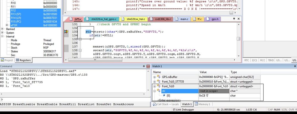

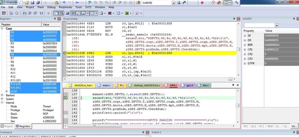

2019-05-02 2:06 AM
Looks like str on the GPVTG is not in scope ?
Captured :
How can I rectify it ?thanks
