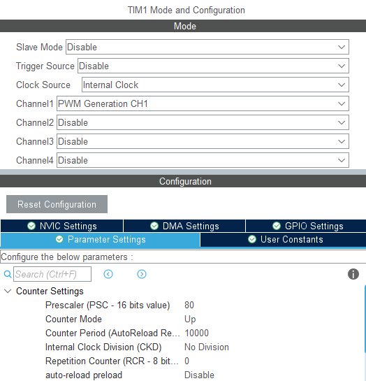

I've got the same issue with the PWM channel mode... I'm not able to create a PWM faster than 100khz...
I need to create a sort of SPI without having even byte alignment...
The final speed must be 158khz, i need to toggle the data pin before the rising edge of clock.
