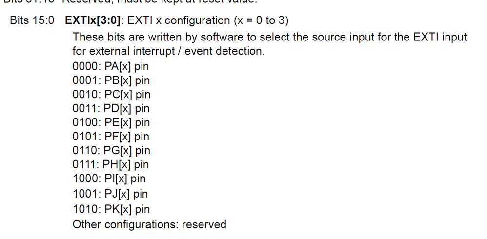

You cannot have multiple ports with the same pin number trigger an interrupt. For example, PA6 and PB6 cannot both be set to trigger an interrupt.
See SYSCFG_EXTICRx for the underlying hardware limitation.
