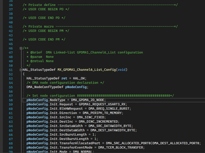

I need a clarification about the configuration of GPDMA1 in linked list mode.
I configure it using Cube MX v6.13.0, here some screenshots I took about the settings done:

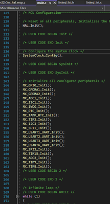

When I generate the code, in linked_list.c file I found the function MX_GPDMA1_Channel6_List_Config that is not called by anyone....is it this correct or I missed some settings?
Thanks in advance for your support.
Stefano

Hello @SteRogge,
You can refer to this article for GPDMA configuration in CubeMX: How to configure the linked list mode in STM32Cube... - STMicroelectronics Community

2025-02-05 2:18 AM
Hello again,
yes, you can also refer to DMA_LinkedList example provided within STM32Cube_FW_H5 under STM32CubeH5/Projects/NUCLEO-H563ZI/Examples/DMA/DMA_LinkedList at main · STMicroelectronics/STM32CubeH5 · GitHub using linear mode
