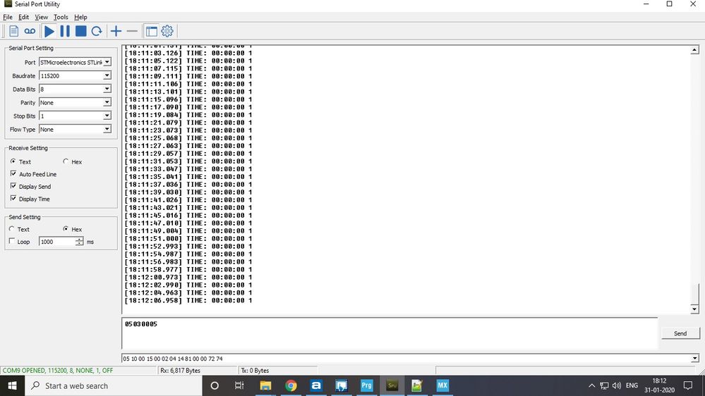

I am using STM32F446RE Nucleo Board and want to read internal RTC timing.
But I am unable to get the time getting 00:00:00

if(get_time(tTime))
sprintf(buffer,"TIME: %02d:%02d:%02d %d\n",tTime.Hours,tTime.Minutes,tTime.Seconds,HAL_RTC_GetState(&hrtc));
send_uart(buffer);

2020-02-01 1:14 PM
You should use HAL_RTC_GetTime() in your function get_time().
