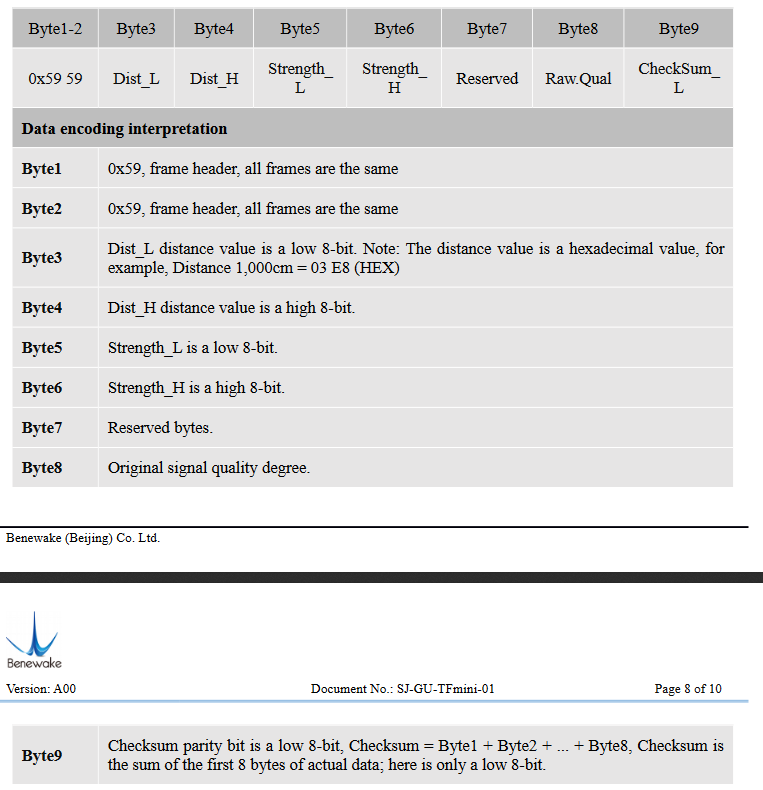

Hi Guys i am trying to get the data from lidar which works on UART and i am using interrupt to get the data value but i am not getting the acc to datasheet of lidar i am using HAL_UART_Receive_IT(UART_HandleTypeDef *huart, uint8_t *pData, uint16_t Size); function to fill my buffer here is the datasheet screen shots
and yes i am using 115200 baud rate.

Should just post the data sheet link? https://www.robotshop.com/media/files/pdf2/rb-ben-03_2017-11-23-benewake-tfmini-micro-lidar-module-ip65-12-m-datasheet.pdf

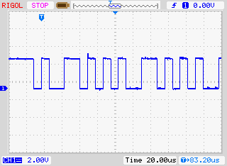

Also the datasheet is outdated this is what i got from oscilloscopeso instead of getting 0x59 i am getting 0x9A and i am using NUCLEO-64.
2018-10-02 11:28 AM
Ok, so a pair of 0x59 bytes, no perceivable inter-symbol gap beyond the start/stop bits. Do you have coverage of the complete frame?

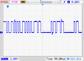

well i am not able to get full waveform so i reduced time scale

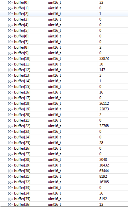

and this is what i am getting from buffer

0x59 = bit reversed 0x9a. Check your USART settings for MSB/LSB first.

You want the buffer as bytes not 16-bit words, you'd need words if you were using a 9-bit mode, but you shouldn't be here.
0x5959 is 22873

The first scope trace is START(0) 10011010 STOP(1), twice

At least on 32L4xx, there is a MSBFIRST bit in USARTx_CR2. Unless I missed it (possible), Divesh doesn't say WHICH Nucleo-64 so I don't know exactly which CPU he is using.
But I think you found the issue w/16-bit data. The sample data he posted shows 2 packets if you unwind the 16-bit data into bytes.
