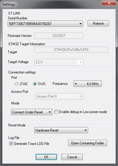

Or connect under reset.

2019-02-14 6:00 AM
Thank to you too @Community member @Uwe Bonnes
I don't try the first method because i've a 0402 resistance in pull down but it could have been done if necessary.
Just to configure ST-LINK in another way
