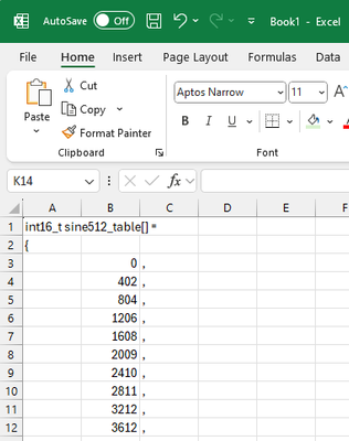

As @Tesla DeLorean , a C array seems easier & neater to me:
int16_t sine512_table[] =
0,
402,
804,
1206,
1608,
2009,
2410,
2811,
3212,
3612,
etc ...
You can do it directly in the spreadsheet - just Save As text:
EDIT: commas!
