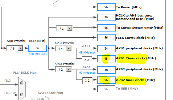

Is there a way to retrieve the value APBx timer clocks are set to?
I have found functions to get the PCLK1 and PCLK2 frequencies but there is a multiplier that can change the final timer clock so that is not reliable.

You'd need to look at the source for HAL_RCC_GetPCLK1() and read the RCC registers to determine if you are the DIV1 case, or not. In the other cases the TIMCLK is 2X
uint32_t PCLK1TIM(void) // F4 Example
/* Get PCLK1 frequency */
uint32 pclk1 = HAL_RCC_GetPCLK1Freq();
/* Get PCLK1 prescaler */
if((RCC->CFGR & RCC_CFGR_PPRE1) == 0)
/* PCLK1 prescaler equal to 1 => TIMCLK = PCLK1 */
return (pclk1);
else
/* PCLK1 prescaler different from 1 => TIMCLK = 2 * PCLK1 */
return(2 * pclk1);
