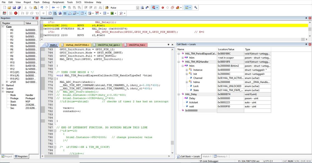

2020-08-20 7:13 PM
2020-08-20 7:23 PM
2020-08-20 7:46 PM
I have this 50us interrupt which comes from the interrupt in order to change the pwm duty cycle using HAL_TIM_SET_COMPARE, and inside my main I have this HAL_Delay(1) which I use to control the LCD. It works fine when I do not insert that HAL_TIM_SET_COMPARE function, but as soon as I add it, the code gets stuck exactly inside that HAL_Delay(1).
2020-08-20 11:48 PM
50us interrupt? You simply exhaust the processor.
