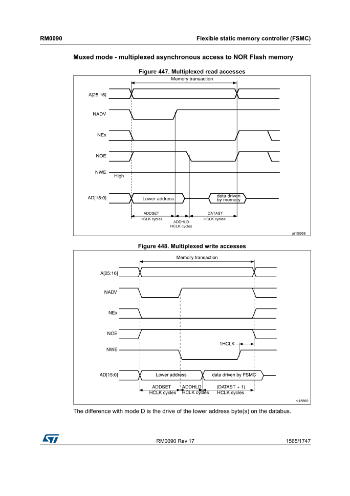

The high portion of address is output onto A16-A23 during the whole read/write cycle.
The low portion of address i.e. A0-A15 is output to DA0-DA15 the first half of the read/write cycle, and you have to latch it using the NADV=NL signal. Then, in the second half of read/write cycle, data are read/written on DA0-DA15.

Thank you for the explanation. So, the higher portion of the address is always output on A[16.23]. OK, given that the ASIC I'm interfacing has only 4-bits of addressing and allows for multiplexed bus transactions, in this case I suppose the address data will be latched on the first 4 DA bits (upon activating Address-Valid signal) and nothing will be output on the A[16.23] lines, right?
