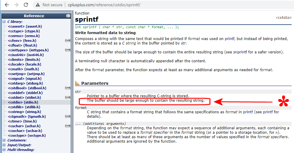

Primary error is sprintf(value, "%f",x); and too value[6]
you need format and one more byte for zero string end, plus include string...
2021-04-07 9:39 AM
So it should be 7, not 6. Can you explain the problem in sptint a little more?
2021-04-07 10:09 AM
I mean you use any float not only this and place breakpoint after sprintf and check string
2021-04-07 10:38 AM
"Can you explain the problem in sptint a little more?"
sprintf() is a standard C library function - you can find details about it in any C reference; eg,
http://www.cplusplus.com/reference/cstdio/sprintf/
