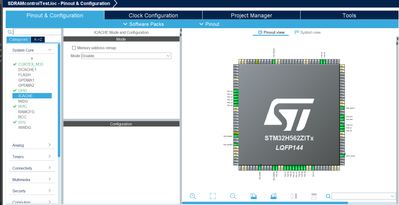

Is the Icache enabled?
If yes, please take a look at this FAQ: How to avoid a HardFault when ICACHE is enabled on the STM32H5 series.
Thank you.
Kaouthar
Thankyou for your answer @KDJEM.1
Neither the ICACHE nor DCACHE is enabled.
