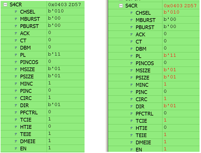

This is my TX DMA stream before error, and after error+reinit, they are the same so DMA should behave the same way
