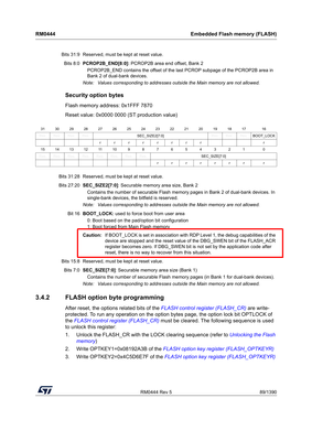

Thanks for reply and your help. I will try it for my boards. I want to ask one more question. My some boards crushed after I upload my code. I can not connect them. There is any way to connect them again ? Can I save my boards ?
2023-06-20 8:03 AM - edited 2023-06-23 12:31 AM
@RE11 At this point, you have lost your board, we suspect that your last code have created OB missmatch that have activated your bootlock.
Regards
Diane

I'm using same boards but this not happening always. I have many boards and they are same. My some boards working well but some of them when I update my code They are not working again. Also I was having F series board too. I didn't experienced it with F series board. But this time I'm using STM32G071 microcontroller and after I enable RDP Level 1 bootlocking this started to happen. After I tried your solution code this didn't fix. Still my some boards not working again. As i said It is not happening always.
2023-06-23 5:30 AM
Maybe you may try to check state of BOOT_LOCK before trying to set RDP1.
I don't know why would BOOT_LOCK be set, but maybe this is the mechanism through which the chips are "lost".
