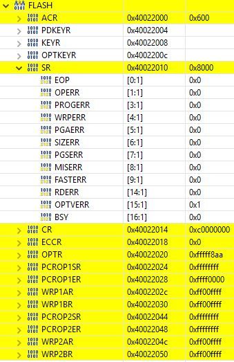

I have the same problem like @URaic in a MxCube4.27 generated project for a STM32L46VET6.
At the beginning of main() FLASH.SR.OPTVERR is already high :(.
