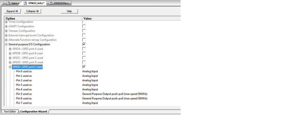

I am puzzled by the wizard screens. None of the GPIOE pins can function as analog inputs. Does the wizard assume the user knows best ?
If the wizard can produce a C code listing, look at that and, if you can't spot the error, post it for review. Cheers, Hal2011-08-30 1:23 PM
