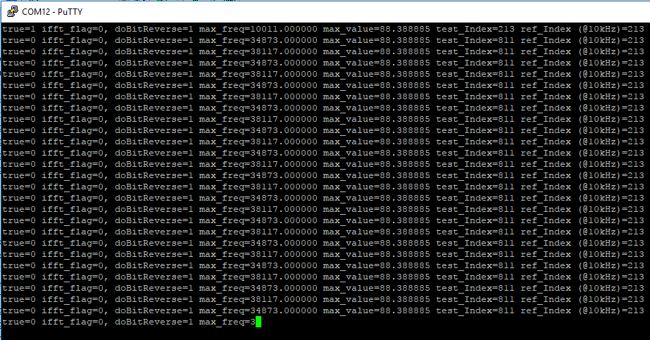

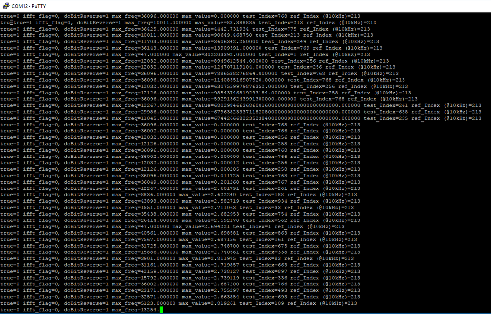

Question-1: Why
frequency
valueschanged unexpectedly? (terminal picture-1)Question-2: Why frequency values isn't equals reference values? (terminal picture-2)
