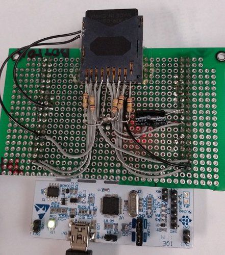

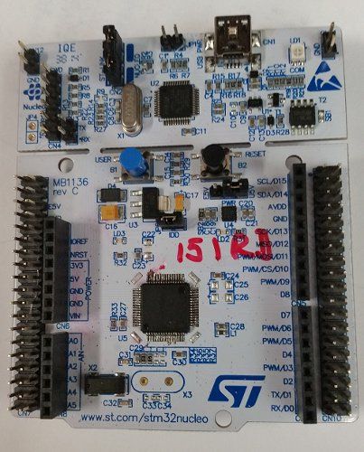

I am having problems with the SDIO interface on STM32L1 series of processors.
The SDIO option is available on the STM32L152D-EVAL, but the price of this board is rather high, so I am working with a modified Nucleo board. The SDIO option is not available on the Nucleo board (Nucleo-L152RE), however, I replaced the stock STM32L152RE with STM32L151RD which has an SDIO. I wired the SD card the same way as it is wired in L152D-EVAL, modified the sample IAR project with FatFS example for STM32L152D-EVAL to change the target (the project is attached) and ran the code.The interface “sort of�? works. My code will attempt 10000 writes, each 512 bytes, to the card, but will crash anywhere between 1 and 5000 writes. It always crashes with error code FR_DISK_ERR that is thrown by ABORT in fs_write:

In addition, 4-bit SDIO refuses to work on any card (tried 5 different cards 1Gb – 8Gb). To see if my soldering skills are to blame, I made another L151RD board and the behavior is identical. Any pointers on getting the SDIO to work properly, complete the writes and work with the 4-bit interface? Am I missing something obvious?

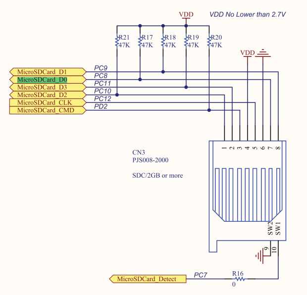

Ok, so what pins are you using? And how is your socket wired up? Looks to be a full size SD card socket. USART output via PA2/PA3 ?2015-02-28 8:29 AM
Thank you!
The socket is a full SD socket, but I am using microSD cards through an adapter. The cards are Transcend, SanDisk, Edge. The wiring is identical to the circuit on 152D-EVAL, and I believe this is the standard wiring for SDIO on all STM32 processors (below). I am not using USART, but these pins are available and connect to Nucleo's RX/TX. Surprisingly, the stock code example provided for the L152D runs fine, but all it does is writes a very short file and then reads it back. That code completes every time I tried it. The problems arise when writing large files as shown in the project attached to the previous post. That code fails every single time and I am left with a partial file. The run time after opening of the file and before failure varies from milliseconds (almost instant) to 5-10seconds, where 1-2Mb get written before failure.2015-03-02 11:56 AM
