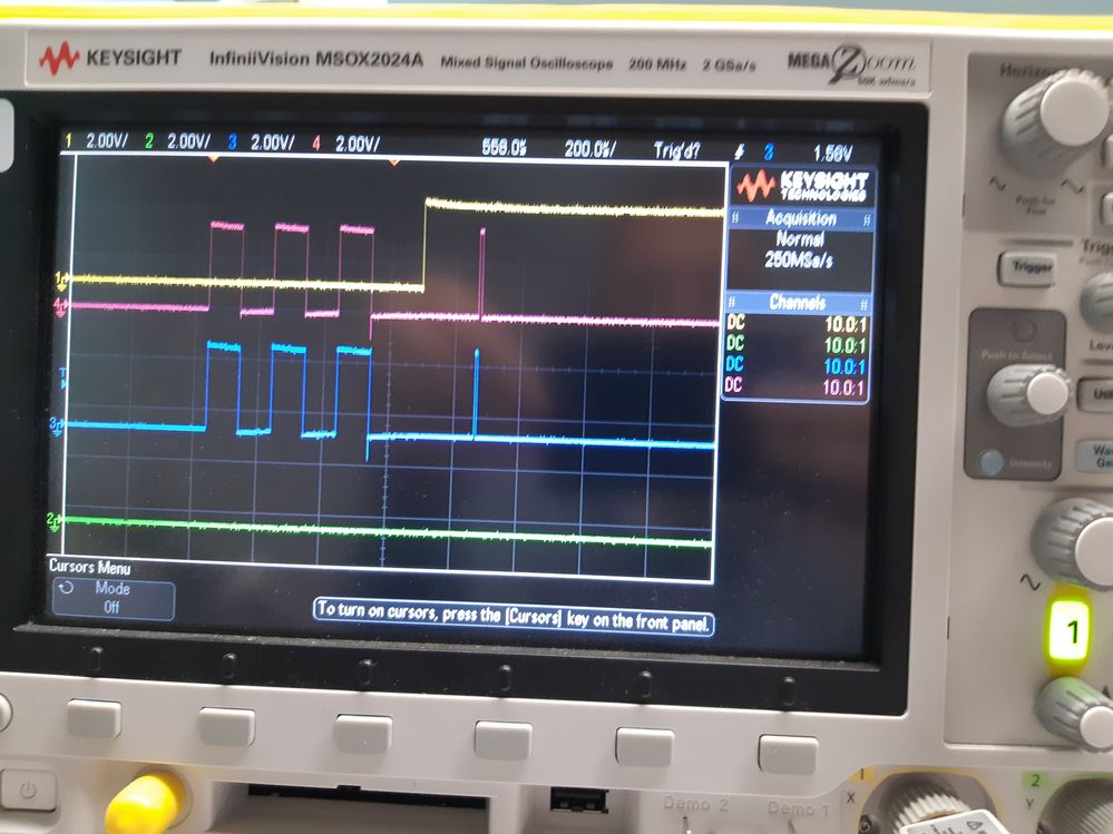

2019-11-25 8:06 AM
Dear Bob,
Thank you for your valuable comment.
Please look at the attached picture.
3 red and blue pulses are just a marker that I am going to init the UART.
Yellow is the UART Rx, it raised immediately after I called the init UART function. Reading your comment I thought maybe my conclusion that the Init UART RX called this low-to-high edge is wrong and actually the device that is connected to my Rx drove the pin high while I am initiating UART was just an occasion. Tried to check that and got contradicted results and then was compelled to postpone this investigation.
You can see on the picture, that there are 1 red and 1 blue pulses that are following the yellow edge. The blue pulse is my marker on the Idle Line interrupt (IDLE Line Interrupt is set) and red is my marker on the Frame Error (FE). The time between the yellow edge and the blue pulse is about 100us which is exactly 1 byte duration @ baud 115200 bps. This is the proof that Idle line is activated upon "10 consecutive "idle" bits on the RX pin".
Even though looking at the FE helps me to filter out this fake Idle line, I think it is worth to take your advise , if that what you advised, and to wait on the Rx line until it becomes high. Will try that.
As for the Pullup, this is a nice idea. I supposed, without checking )-: that if we select a post as Alternate, we have no Pullup configuration, but it was a mistake. GPIO can be both alternate and PU.
Will check this a bit later.
Thank you once again for your help!
