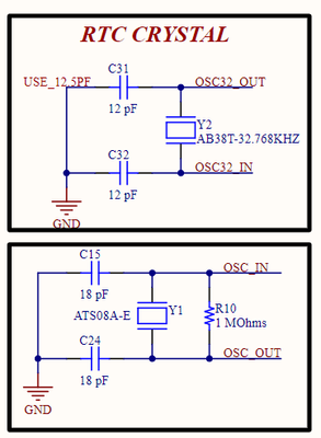

I am currently working with the STM32G0B1CET6 microcontroller and using two Abracon crystal parts, ABL-8.000MHZ-B2 and AB38T-32.768KHZ-B. However, I am encountering issues with the crystal when I use heavy ( like code more than 50% ram & flash of this STM-g0) percent of my code in STM. Attached is the schematic for your reference.,

Can you please details what kind of issues , waveforms of signals. Try to output value of the LSE or HSE on MCO pin to understand the case . Also the PCB routing . I would recommend to try to isolate where these issues are coming ?
R10 is not necessarily and may create issues - it is not recommended . For LSE 32,768Khz to know the selected drive level with LSE - I see such crystal is 12,5pF CL and is not compatible with lower drives .
this is our reference App Note : https://www.st.com/resource/en/application_note/an2867-oscillator-design-guide-for-stm8afals-stm32-mcus-and-mpus-stmicroelectronics.pdf
hope it helps you .

I'm hard pressed to draw a relationship between code size and crystal function.
Focus on other potential issues as more direct causes.
Make sure you actively clear auto/local variables.
Make sure you use appropriate flash wait states for speed and voltage considerations.
"crystal " has nothing to do with your code size.
So you do something in your code, that is very wrong.
What are the "issues with the crystal " ? which crystal (you show both) ?
How you know, its the crystal and not your code ??
