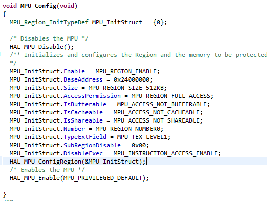

2021-06-14 2:52 AM
i solved your problem with this configuration MPU:
