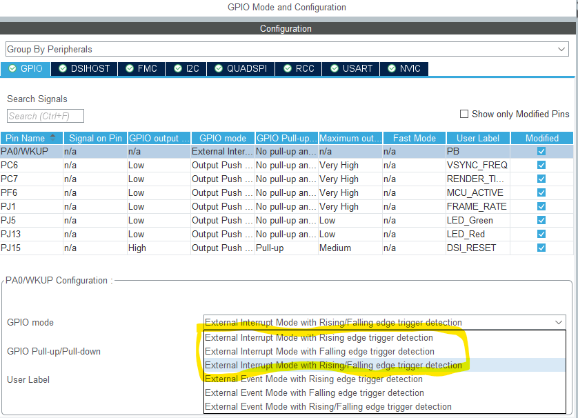

Enabling EXTI line[15:10] is 1 of 2 things that needs to be enabled. I believe by default External Event Mode is enabled but you want External Interrupt Mode.
2023-01-11 8:19 AM
I posted before I saw this post, but yeah that is what I was talking about.
