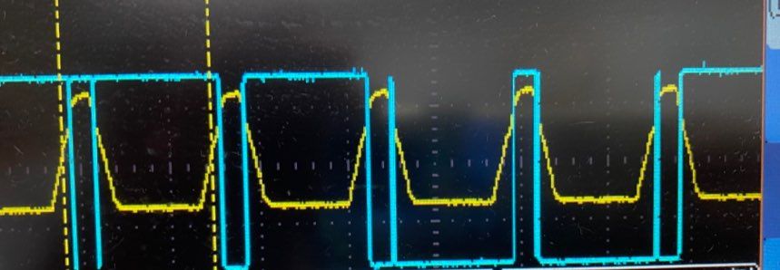

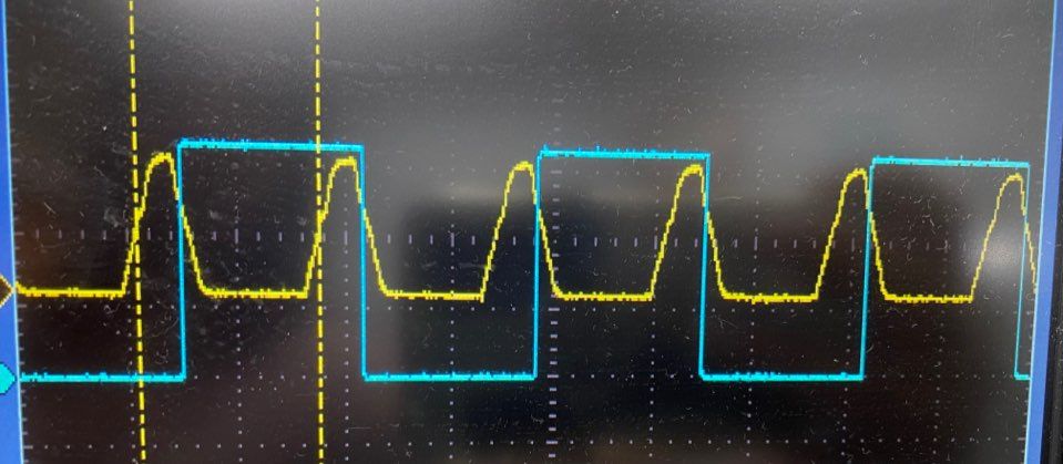

2020-07-20 7:26 PM
Modified the exti function to only execute gpio toggle.
Photo 1 is the interrupt operation to be implemented. (Toggled for each falling edge.)
The second picture is case2.
The data is changing within a short period of time as if some data was being transmitted.

2020-07-20 10:28 PM
By enabling FMC you added noise and exti triggers on that.
2020-07-21 2:29 AM
It is clear that there is noise around the trigger threshold of exti.
The exti1 signal must have much steeper edges.
