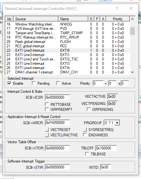

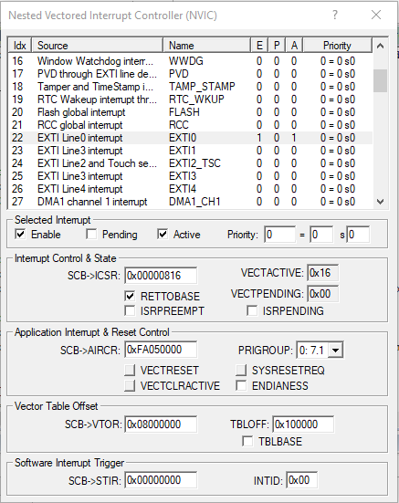

}and in the debug view i can see that the processor triggers the interrupt, but it just stuck the program and the interrupt is never executed:
before pressing the button connected to PC0:
after pressing the button:
