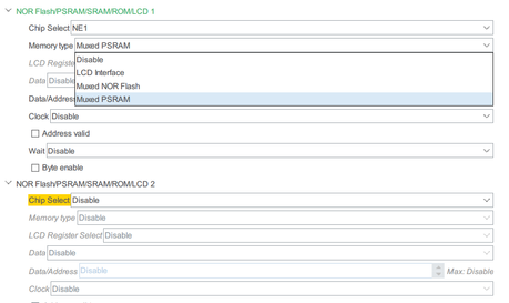

I'm working on a project using the STM32H723VGH6 (due to size and design constraints, I can't use the ZG series) and I want to expand the RAM by connecting an IS62WV51216 SRAM. However, I noticed that in CubeMX, the FMC configuration only has a "Muxed PSRAM" option and no SRAM option (the ZG series has an SRAM option in CubeMX).
Even with the PSRAM option, I found that PSRAM typically has both address lines (Ax) and data lines (Dx), but CubeMX only shows pinout for data lines, not address lines.

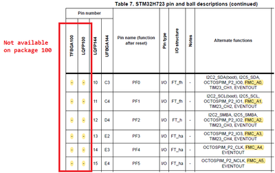

STM32H723VG is a TFBGA100 package contrarily to ZG (LQFP144 package ) some FMC signals are not available on that package like FMC_A0 to to FMC_A15 address lines. So you need to use "muxed" config in that package i.e. using FMC_AD0 to FMC_AD15: they are multiplexed Address and Data lines which are selected by FMC_ALE (Address Latch Enable).
See datasheet:
But here you need either a memory supporting the mux mode or you need to add an external Latch to hold the address while handling the data.
But as I can see from IS62WV51216 datasheet, it does not support the mux mode so you need to add an external latch (managed by FMC_ALE).
See datasheet:
