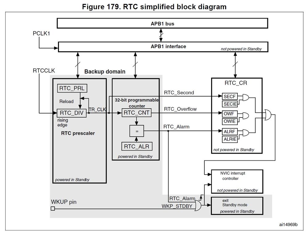

I'm using STM32F100RBT. How can I use HAL_RTCEx_SetSecond_IT to exit STANDBY mode?
I'm able to exit STANDBY using ALARM, and able to get an interrupt every second using HAL_RTCEx_SetSecond_IT , but I can't wake up from standby with it.
What should I do?
Is there an example project?
Thanks!
2019-11-17 10:15 AM
Not really wired to work that way, perhaps you should just SLEEP for short duration stuff?
