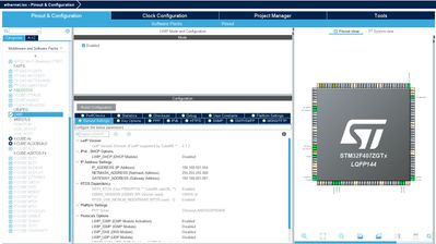

I use Lwip and FreeRtos Cmsis_v2, I set this config in cubemx, but in ping test ops!
what is my mistake?!
Thanks.
1-sys config
2-ethernet config
3-freertos

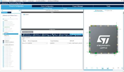

4-lwip config

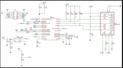

phy drive:

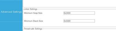

5- heap and stack
6-module schematic

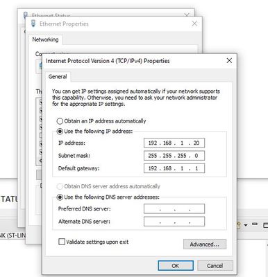

7- pc ip4 set

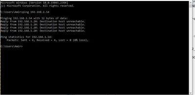

8- ping test in cmd
2024-03-16 3:36 PM - edited 2024-03-16 4:34 PM
> what is my mistake?
Relying on CubeMX/IDE to generate a 100% working code.
Please start from a ready example from the Cube F4 library /Projects/ board/Applications/LwIP...
Find a board that is most compatible with yours.
Do not generate or change anything before you see the project working.
2024-03-17 8:58 AM
Hi
I connect NRST lan8720 to NRST f4 and be ok, just for a Reset !!!!
