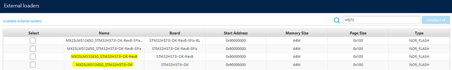

Please provide more detail of the exact board configuration, external memory, and external loader.
Provide logs from STM32 Cube Programmer, with Verbose Level 3
@KDJEM.1
Here is screens and level 3 log file

Which board revision are you using?
If you have a STM32H573I-DK-RevA board , please use MX25LM51245G_STM32H573I-DK.
If you have other boards revisions like as RevB or RevC, please use MX25LM51245G_STM32H573I-DK-RevB.
Please let me know if the issue is solved or not?
Thank you.
Kaouthar
It works thank you for helping.
