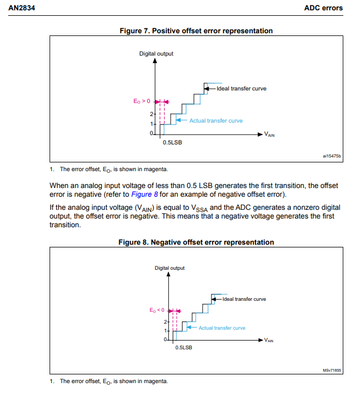

I spotted an error in AN2834 rev 9, figure 8. Please refer to the image attached.
A negative offset error should be depicted in figure 8, but it is a positive offset error, just like in figure 7. To be a negative offset error, the actual transfer curve has to be offset to the left of the ideal transfer curve.

Thank you for reporting this. I've escalated to the Concerned team for more investigation and correction (under internal ticket number 184479). Thanks again for your contribution.
