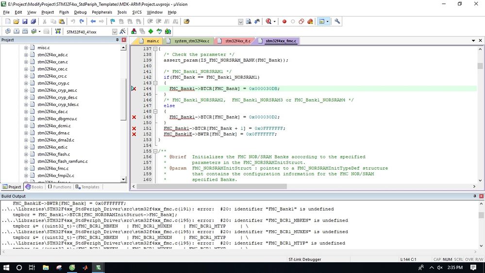

Hello everyone. I have a problem with Stm32f407IGH EVAL.
I coppy template of source code to other file. I also modified path include.
But when I compile, build output have 30 error, all error in file stm32f4xx_fmc.c file, like FMC_Bank1 undefined, FMC_BCR1_NBKEN undefined ... I don't understand why error because everything same the code template.
Please help me with this problem. Thank you.

Make sure the compiler's command line defines correctly set the model of CPU you are using as these control the defines/structures used by different peripherals. ie expect F407 to be different to F427
With SPL code I would expect the F407 to need to use the FSMC rather than FMC

Thank you for your reply. I'm totally complete to solve this problem.
