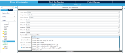

Currently, I try to use an quadrature encoder connected on pins PC12, PC11 and PC10. All these pins have in common that they all can use Timer 8, for channels CHN1, CHN2 and CHN3. When I try to configure Timer 8 in Encoder mode; I can't select the CHN channels. Is there a way to use these pins as input for the encoder?

To put more bluntly the same thing @Sarra.S said above: TIMx_CHxN pins cannot be used as inputs, only as outputs.
