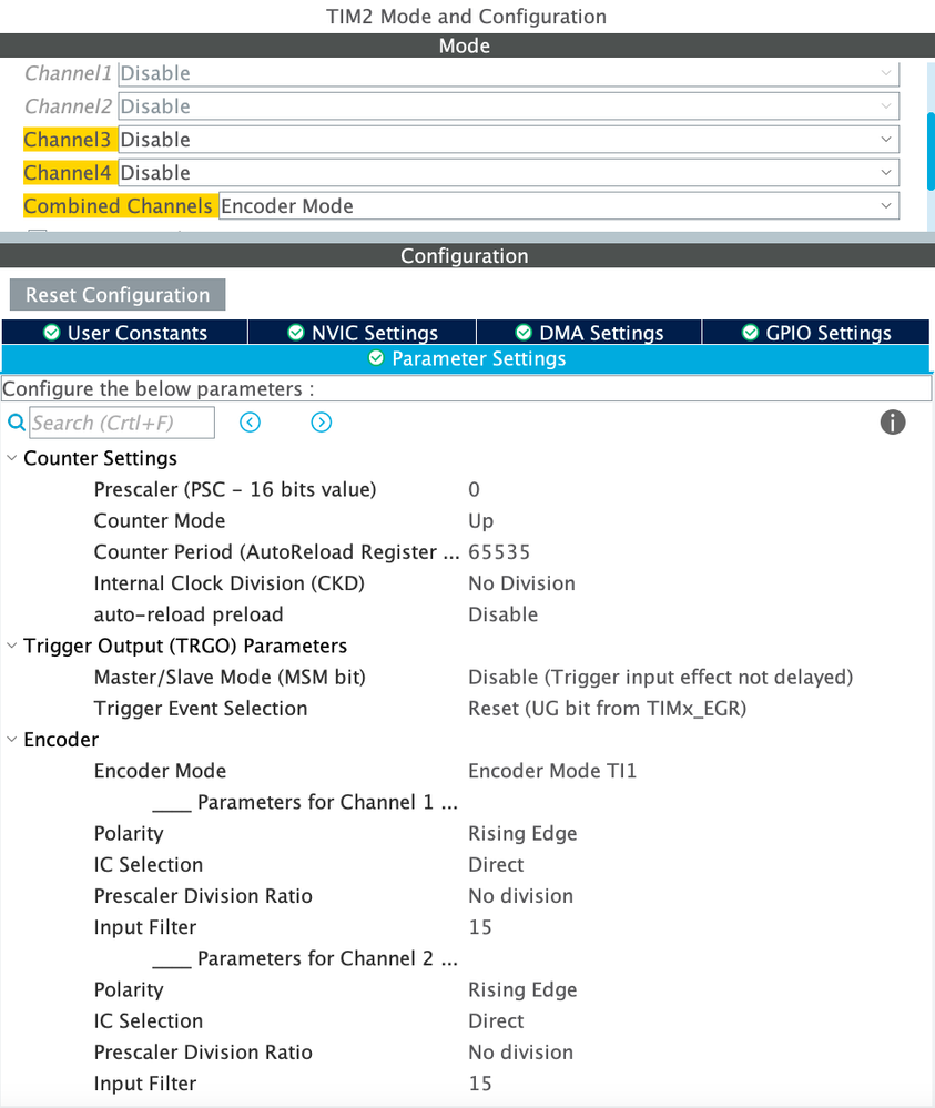

2021-01-26 10:00 AM
Yes I'm aware of the 32-but counters but how would that matter here? I did not want to paste a wall of standard CubeMX auto-generated code but here is the configuration of the timers, Its configured only for the rising edge of TI1

}This is the CubeMX configuration for the timers,

looks like timer is just count one up then count down,and repeat. You could try change one of the ICPolarity to falling edge.
2021-01-27 1:18 AM
That did not work. Yes instead of counting to 65535 it counts only 0 or 65535.
2021-01-27 7:39 AM
For the encoder mode, do both inputs need to be active? I ask because I only one sensor and hence only one input is active.
2021-01-27 7:53 PM
I see you only have one active signal. you should use External Clock Mode 1. use this signal to clock the timer is appropriate . Another way is to change TIM_ICSELECTION of the inactive input signal to INDIRECT. this may work.
2021-01-28 3:22 AM
I don't see any of these parameters in the configuration menus. For ICSELECTION I only see DIRECT.
2021-02-17 12:44 AM
It seems that encoder is configured to use 2 pins, so you need the two inputs, with signal in quadrature. This allows the counter to identify if value should be increment or decremented.
As you have only one signal changing, the counter is doing +1 then -1 then +1.
Pin sequence should be like : 00 then 01 then 11 then 10 . If you change the direction, it will do 00 10 11 01.
