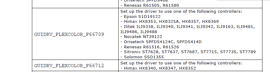

Just after a raw investigation , found that you are not use the correct driver for your LCD. Inside LCDConf_stm32l10e_eval.c the GUIDRV_FLEXCOLOR_F66712 is for other LCD module.
For ILI9341 use GUIDRV_FLEXCOLOR_F66709
Also STemWin, CubeMx, firmware libraries are not updated to latest version.
