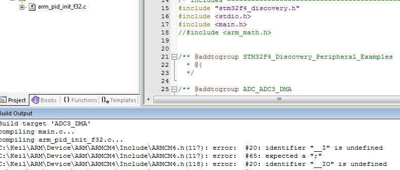

I need to use DSP libraries such as BasicMathFunctions, but I have a lot of error messages, you might describe the procedure to include these libraries??
error messages like:.. \ main.c (18): error: ♯ 5: can not open source input file ''ARMCM4.h'': No such file or directoryTarget not created #dsp-libraries2012-10-15 7:41 AM

Your file
arm_pid_init_f32.c
pulls inarm_math.h
. Inarm_math.h
, you find this: ...#define __CMSIS_GENERIC /* disable NVIC and Systick functions */
#if defined (ARM_MATH_CM4) #include ''core_cm4.h'' #elif defined (ARM_MATH_CM3) #include ''core_cm3.h'' #elif defined (ARM_MATH_CM0) #include ''core_cm0.h'' #else #include ''ARMCM4.h'' #warning ''Define either ARM_MATH_CM4 OR ARM_MATH_CM3...By Default building on ARM_MATH_CM4.....'' #endif ... So, just add the define ARM_MATH_CM4 to your project settings. The filecore_cm4.h
is coming with the DSP_Lib, so there shouldn't be a problem.2012-10-15 8:22 AM
Do you have the define ARM_MATH_CM4 set for the project?
