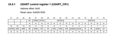

Reading the STM32L051 datasheet and register reference, it seems like the CK and TX functionality can be assigned to suitable pins as alternate functions without having to also assign RX (which I don't need) to a pin. And then beyond that, I could also disable the receiver functionality of the USART itself. This would let me use this USART to latch out data and clock without having to waste an IO pin on the unneeded USART_RX.

RX not required.
Could also perhaps drive via GPIO. Or remap existing SPI peripheral to an alternate pair of pins if you can control/sequence ownership
