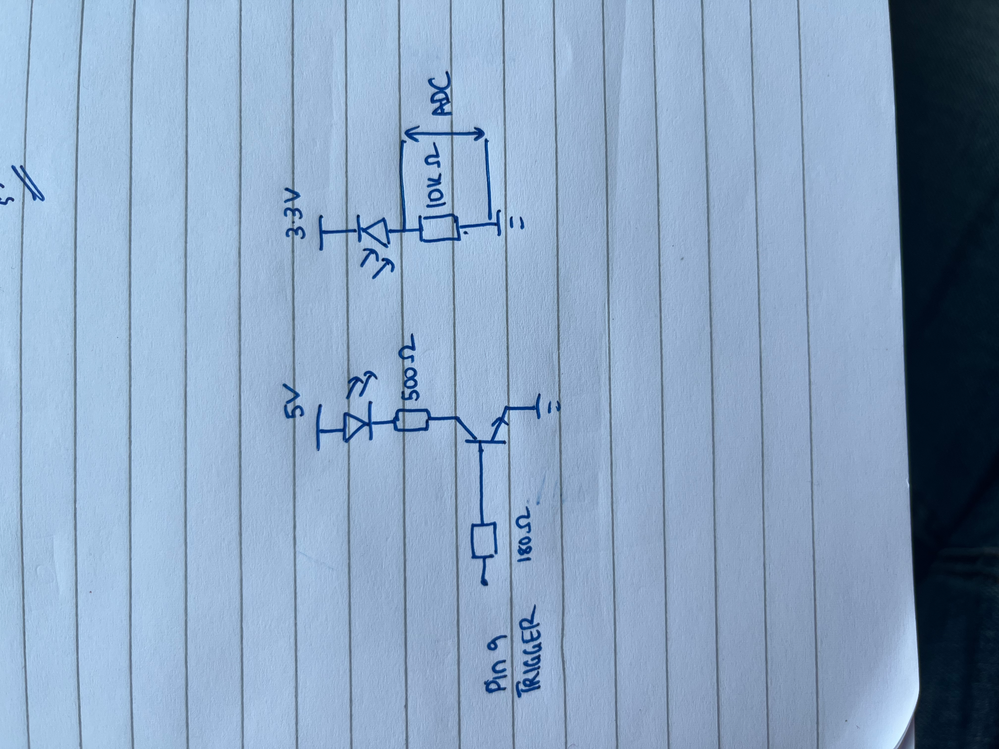

Hello.
Find the attached circuit diagram for my IR sensor. The trigger is built in such a way that when it's off the IR transmitter is off and we get the sunlight values and when it's on we get sunlight + IR value and when we subtract the two we get the resultant. But my code doesn't dsiplay any value when the IR transmitter is on. Here's my code. Please help. When I add a breakpoint it never gets triggered by the if loop where the trigger or pin 9 is set.

Are you trying to read and write from the same GPIO?
How did you configured gpio A-9, output or input?

I'll be surprised if it works. Normally the photodiode has much too small current to be sampled by ADC, unless you direct a laser light onto it. For light intensity sensing without an amplifier use phototransistor or LDR. For IR remote reception - use a dedicated circuit, like TSOP1836.
