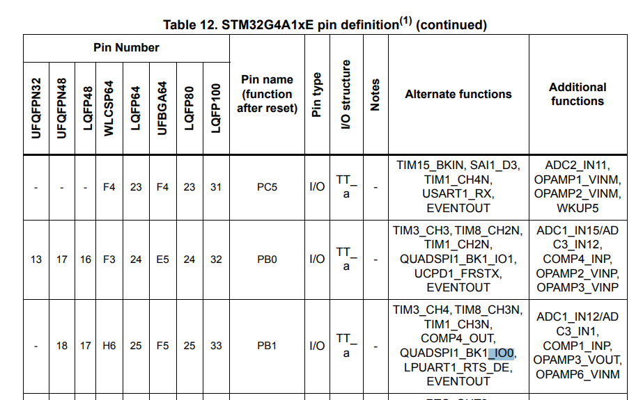

The data sheet for this family of parts mentions a Quad-SPI, butaccording to the datasheet the QFPN32 package does not appear to have QUADSPI_BK1_IO0 exposed to a pin (see picture). The Quad-SPI configuration in 1x/2x/4x IO mode all appear to require the IO0 signal.
Is it possible to use Quad-SPI in this package?

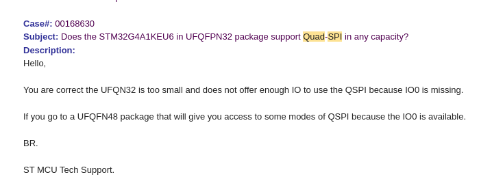

Update: It does not.
1 REPLY 1
JAlej.1
Associate
