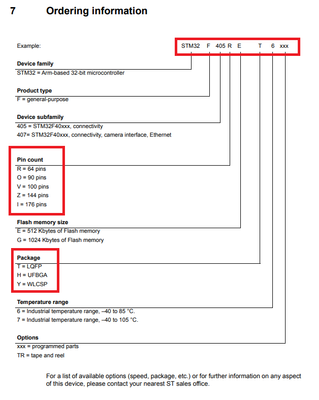

2024-10-10 1:33 AM
Yes it's the F405.
For your question about the package, please refer the datasheet, Section 7 Ordering information:
