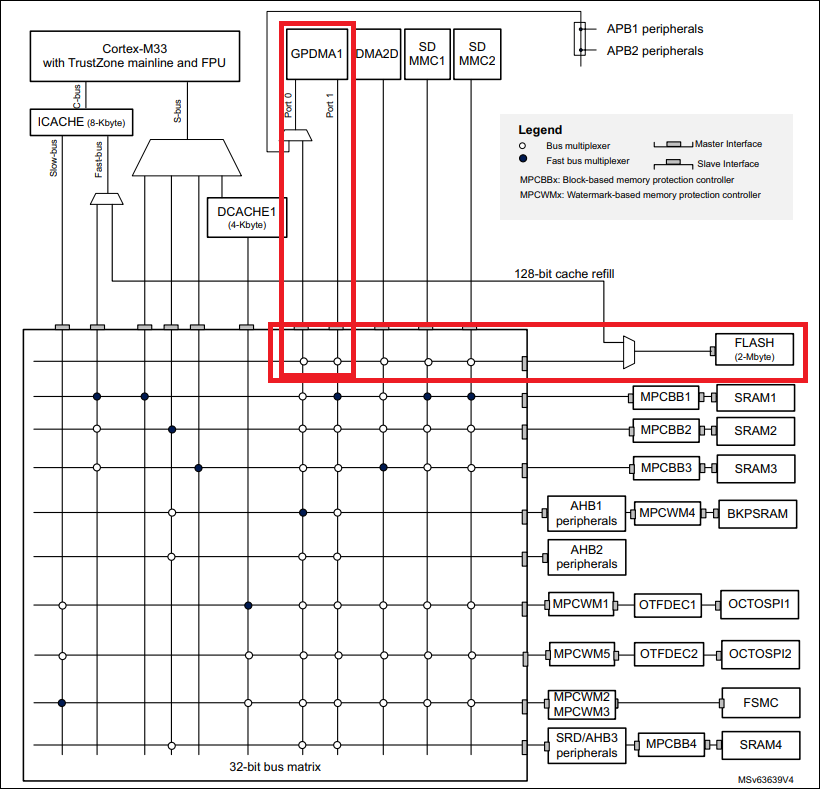

"STM32Cube_FW_U5_V1.1.0\Projects\NUCLEO-U575ZI-Q\Examples\DMA\DMA_FLASHToRAM"
Also in the reference manual in Figure 1. System architecture in the bus matrix there is a link between the internal Flash and the GPDMA, so the GPDMA support writes to internal Flash.
the snapshot below highlight the communication link between the GPDMA and the internal Flash.
Mohamed Aymen
2022-07-27 7:56 AM
@Mohamed Aymen HZAMI Thank you for taking the time to respond. Unfortunately, I do not think this provides any new information. I already mentioned the Flash-to-RAM example in my original post; that example doesn't tell me much about DMA transfers in the other direction (RAM-to-Flash). The diagram shows the DMA is linked to flash, but it doesn't clarify if it's really bi-directional.
