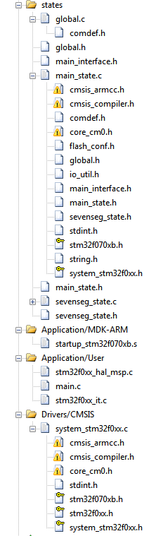

I would like to keep attention to those users who are using cubemx codes in mdk keil environment.Take a look at my build console output, its a common error I know,C:\Keil_v5\ARM\PACK\Keil\STM32F0xx_DFP\1.5.0\Device\Include\stm32f070xb.h(130): error: #5: cannot open source input file ''core_cm0.h'': No such file or directory
If you look the project branch its looks like ARMCC of keil does not support the CMSIS driver!!2016-11-21 2:33 AM
I think you haven't configured the Include paths within the project.You have to review the defines and provide the compiler with a list of include file paths.Regards2016-11-21 8:53 PM

Thank you very much to text here.I haveselected the device startup in MDK 5., like selecting CMSIS:CORE and Device:Startup .
And also, after generating a code in cubemx, I have followed the include path same to example project.Now it works,but build errors exists as I am compiling a complex project.

The audience here is finite. You can also review tool chain documentation, and examples. For staffing, ST maintains a list of consultants and contractors, and has FAE support for large customers.The Keil project tree really only wants the .C files dropped into it, it can find the include file dependencies via the Include Paths, and it doesn't need to explicitly compile/build include files, as they shouldn't really be contributing source code to build.2016-11-22 6:14 PM
