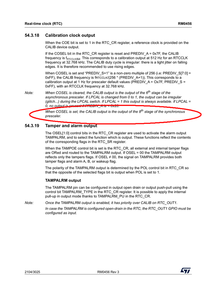

However, this is all dependent on the 1Hz calibration output being aligned to 1 second RTC boundaries. I don't know if this is the case or not.
I don't understand your question.
Does this answer it?
However, you still may be disappointed by the fact that the 1Hz signal may easily exhibit jitter of a couple of us, as the LSE oscillator output fluctuates around the decision point of the subsequent input comparator.
