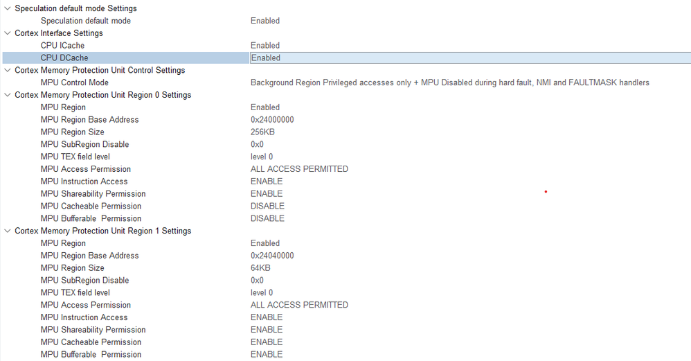

1. I have modified the STMxxx_Flash.ld linker file by adding some memory sections. Does the sequence of SECTIONS definition matters? LinkerScript.ld and MPU Config Added.
Layout:
ITCM -> Has some functions
DTCM-> non DMA Global Variables
D1 RAM (First 256KB)-> DMA Buffers with Cacheable and Bufferable Disabled in MPU Region
D1 RAM(Last 64KB)-> Data benefitted from caching with Cacheable and Bufferable Enabled in MPU Region
2. Vector Table and ITCM have the same start address (0x0000 0000). I have to do anything or its handled already?
3. Did i modified the heap-stack section correctly for it to work from DTCM.
