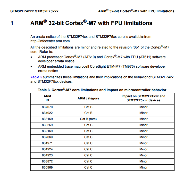

One of the threads went through a couple of edits, but the NUCLEO-F767 had the r1p0 part, the FPU-D and 2MB of FLASH
The FPU-S devices probably just going to be the r0p1 core, unless ST steps the part, and that would reflect in the errata documentation.

2017-03-14 3:23 AM
Hi Clive,
There is no plan for new device revision for F74xxx and F75xxx products.
So, there is no plan to embed a new core revision.
Thanks
