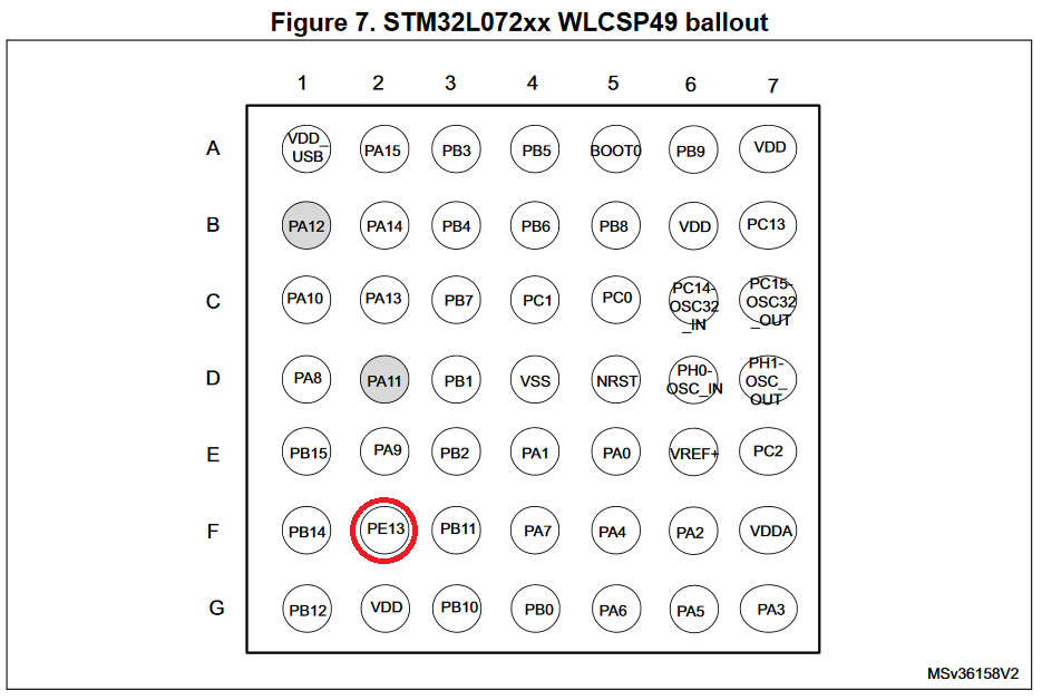

http://www.st.com/content/ccc/resource/technical/document/datasheet/98/e1/71/c0/ae/f5/4b/d4/DM00141133.pdf/files/DM00141133.pdf/jcr:content/translations/en.DM00141133.pdf
Ball F2 should be PB13 not PE13

Thank you for your reported error. I will raise this internally to fix it in the coming release.

Thanks, the data sheet was internally inconsistent, the Murata LoRa module uses this chip and the PB13 signal, which is why I noticed it here. Please check where else this ball map is used.
