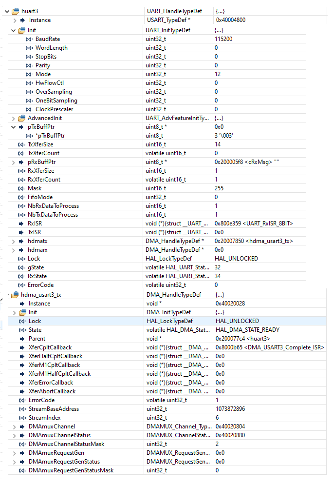

All the HAL routines return "HAL_OK". I've tried downloading the NUCLEO project onto \the DISCO but it fails during the SystemClock_Config(). (The DISCO has a 25Mhz clock whereas the NUCLEO has an 8Mhz input clock). In both CUBEMX settings, the core and peripheral clocks are the same for both projects.
The address for the DMA -> UART TX source is a local variable, which seems like it could be an issue, but the NUCLEO board has no problem with it. However, Just to be safe, I made it a global, and it still works for the NUCLEO, and still does not work with the DISCO board.
strncpy ( cDbgMsg, "Ready USART3\r\n\0", strlen("Ready USART3\r\n\0") );
// Set DMA as source of UART Tx Buffer
huart3.Instance->CR3 |= USART_CR3_DMAT;
HAL_DMA_RegisterCallback ( &hdma_usart3_tx, HAL_DMA_XFER_CPLT_CB_ID , &DMA_USART3_Complete_ISR);
HAL_DMA_Start_IT (&hdma_usart3_tx , (uint32_t)(cDbgMsg), (uint32_t)&huart3.Instance->TDR, 10 ) ;
HAL_UART_Transmit_DMA ( &huart3 , (uint8_t*)(cDbgMsg), strnlen (cDbgMsg, 16) ); Looking at the pertinent DISCO Uart and DMA registers, it seems like the settings are all there:
2020-08-17 6:35 PM
